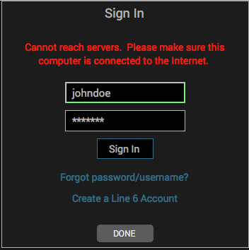

As a result, any software using Apple’s system for secure communication, including ours, is no longer be able to connect to its targeted servers. Below are a couple of examples of what a user subject to this issue will run into:
https://line6.com/media/ips/uploads/monthly_2020_06/image.png.280ea5cba7b97e6cadda2bbead067059.png
https://line6.com/media/ips/uploads/monthly_2020_06/image.png.b19855bf300dc5f7329974df8830a2b9.png

As of June 1, 2020, macOS 10.11 (and earlier) users:
·         will be warned by Safari that the connection to Line6.com is not private
·         will not be able to install Helix Native or Helix Marketplace licenses on their macOS computer after they make their purchases on the website.  Users that have already made purchases and already installed their licenses are not affected.  It is only *new* purchases made from this date forward.
·         will not be able to install/run the trial version of Helix Native.
·         will not be able to use the Line 6 Updater to inform them of the latest firmware releases.  Users will have to go to https://software.line6.com, download the firmware file using a web browser, and use Line 6 Updater in Offline mode.
·         will not be able to update their Helix firmware using HX Edit.
·         will not be able to update their POD Go firmware using POD Go Edit.
