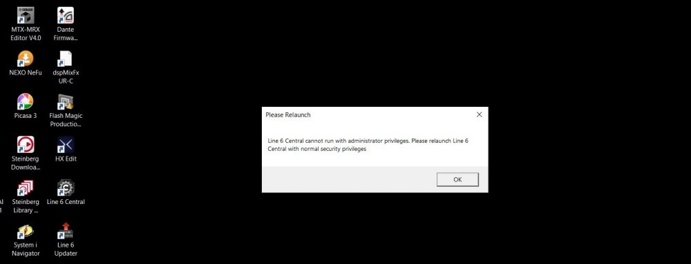

"Please Relaunch" Error Message
The Line 6 Central app cannot be run as administrator on any Windows system. If you experience this error message, we suggest you go to the root .exe file (C:/Program Files (x86)/Line 6/Line 6 Central), right click it, select “Properties”, and uncheck “Run this program as an admin” located in the Compatibility tab.
