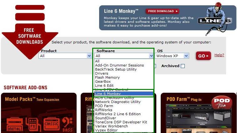

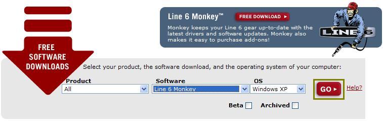

2) Download the latest version of Line 6 Monkey for your operating system from the Line 6 software page. Go to the following link for software downloads:
Line 6 Software Downloads

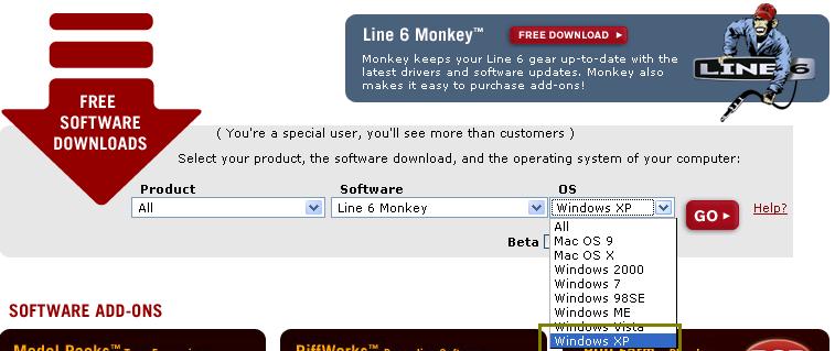

3) You can leave the "product" set on "all", then select Monkey from the software dropdown menu.
4) Select your Operating system ("OS") from the next dropdown menu. For this installation we will select Windows XP.
5) Select "go"

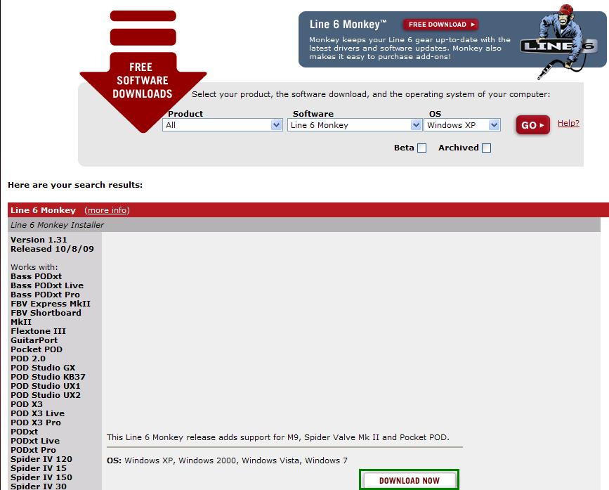

6) The first program at the top of the page will be the latest version of Line 6 Monkey available for download. Select the "download now" icon to download the program to your computer. We recommend saving the installation file to your desktop so it is easy to find.

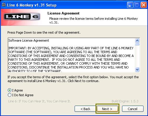

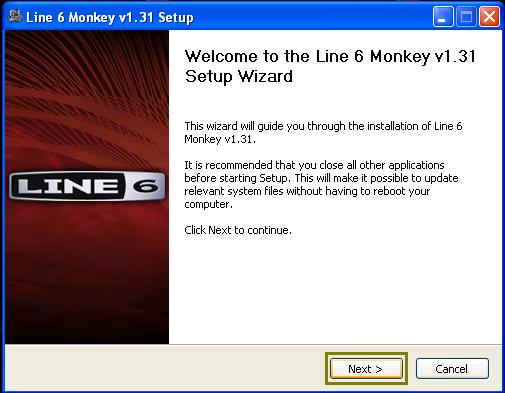

7) Once Monkey is downloaded you will need to install the program to your computer. double click the installation icon to see the following window, then select "Next":
8) Agree to the license by clicking on the "I agree" and select "next"

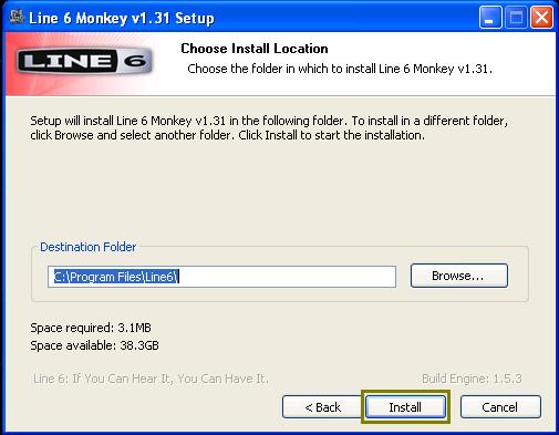

9) Select "Install"

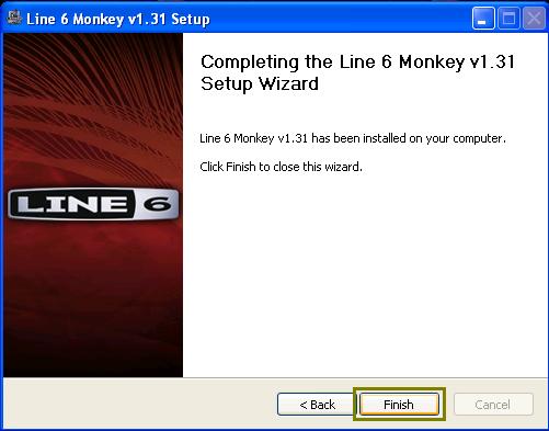

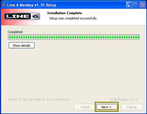

10) Select "Next" when the installation is complete

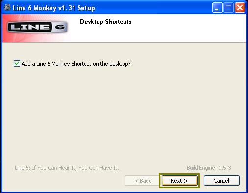

11) Choose if you want the Monkey icon on your desktop and select "Next"
12) Select "Finish" to exit the installation process.

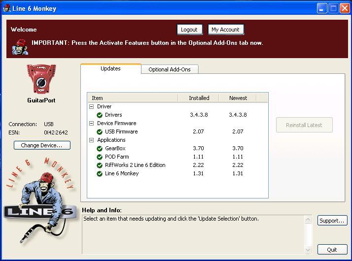

When the installation is complete you will run Line 6 Monkey. Choose the hardware device you wish to update. Once you have selected the unit you will be prompted in the updates tab to download the appropriate software and drivers for your unit. See the following documents for driver installation information:

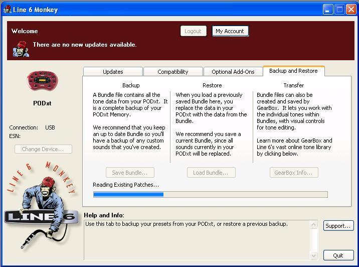

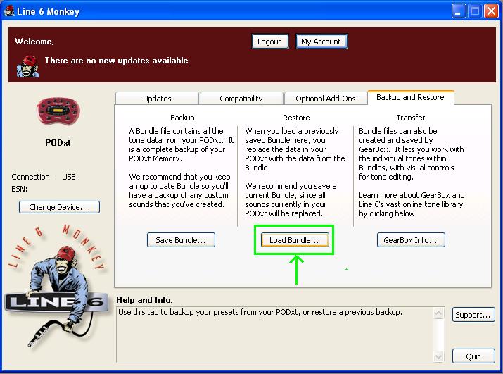

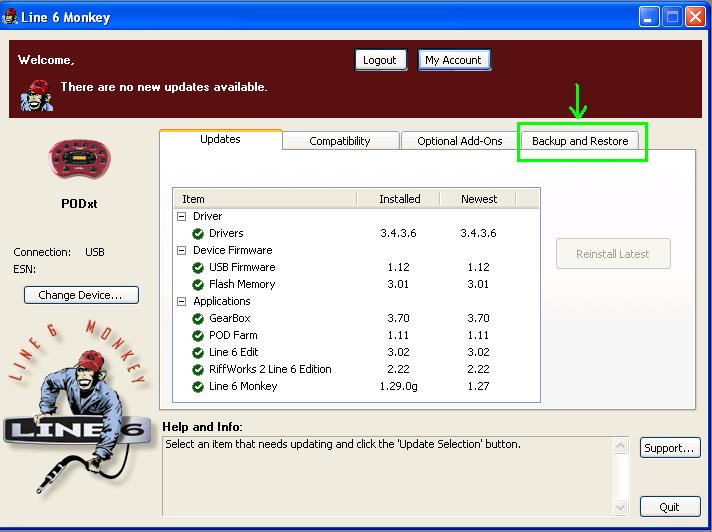

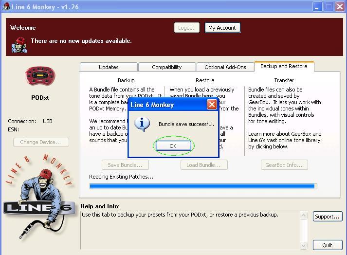

Q: How do I restore a tone bundle (all the presets) via Monkey?
1) Launch Line 6 Monkey and ensure that all the software is up to date. Then select "Backup and Restore." For this example we will use a PODxt device.
2) Under Restore, select "load bundle"

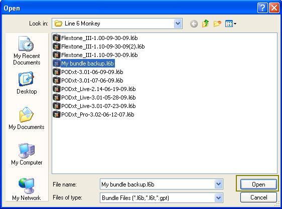

3) Select the bundle you want to load, then select "open".
4) Monkey will ask if you want to replace the presets in your unit. Select "yes".
5) Wait for the patches to load, then select "OK" when the patches are loaded.
