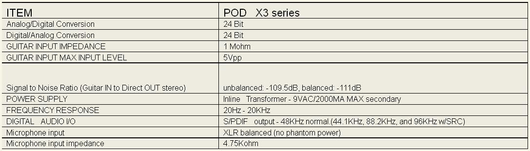

Q: What are the hardware specifications for the X3 series?
