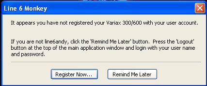

1) Once you run Line 6 Monkey, Monkey may ask you to register. If you do not wish to register (or have already registered) select "remind me later".

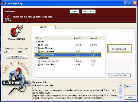

2) If you want to reinstall the factory presets (or update the firmware), select "Flash Memory" the select "Reinstall Latest"

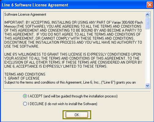

3) Select "OK" to agree to the software license

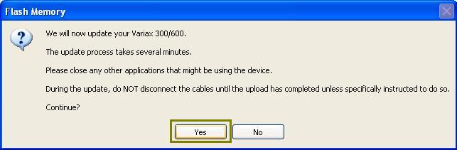

5) Select "Yes" to continue with the update. Do not disconnect the variax during the update.

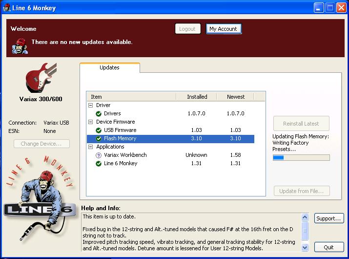

6) Line 6 Monkey will reinitialize the device and update the flash memory. You can watch the progress on the blue bar on the right side of Monkey.
7) Once the update is complete you will need to select "OK" to continue.
