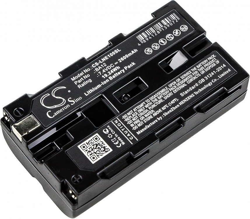

Unfortunately, production of the Lithium-Ion battery packaged with the JTV, Shuriken, and Variax Standard has been discontinued by the manufacturer.
For US/Canadian/EU/UK customers, although it is not an official Line 6 part, we’ve found that the Cameron Sino battery model CS-LNE100SL works as a generic replacement to the original Gen 2 Variax battery. Performance may vary between units.
This battery can be found with a Google search at multiple online retailers, but for simplicity, here is the Amazon link:
https://www.amazon.com/LIONX-CS-LNE100SL-Standard-Shuriken-98-034-0003/dp/B0CGRT3K8X
Model Number CS-LNE100SL in detail:
https://line6.com/media/ips/uploads/monthly_2024_10/673167319_CS-LNE100SLJTVbattery.thumb.jpg.f715f4c1268689bf51fda18cfeb0d79a.jpg
