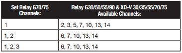

Using G70/75 with other Line 6 wireless (RF Co-habitability)
Even with RF2/ RF3 co-habitability - that does not necessarily mean that every channel will work in the same environment. Check out this chart as to what channels are available when using our other Relay products.
https://line6.com/media/ips/uploads/monthly_11_2015/ccs-1912763-0-07568200-1447873482_thumb.jpg
Note:
The G70/75 will ONLY work in the same environment as current RF2 wireless systems. Those Relay systems with older firmware (v1.0) will not work in the same environment unless the G50 is updated to firmware 2.0 or better.
