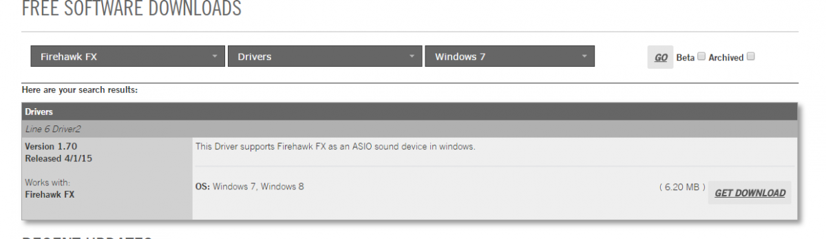

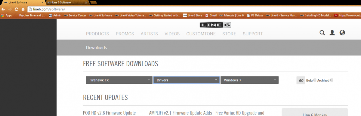

1. In order for your computer to see the Firehawk you will need to install the driver for the device to your computer. open a web browser and navigate to line6.com/software and select Product: Firehawk FX Software: Drivers from the drop down menus at the top of the page.
2. Pick the top selection from the next page by selecting "Get Download".

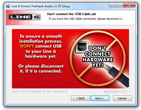

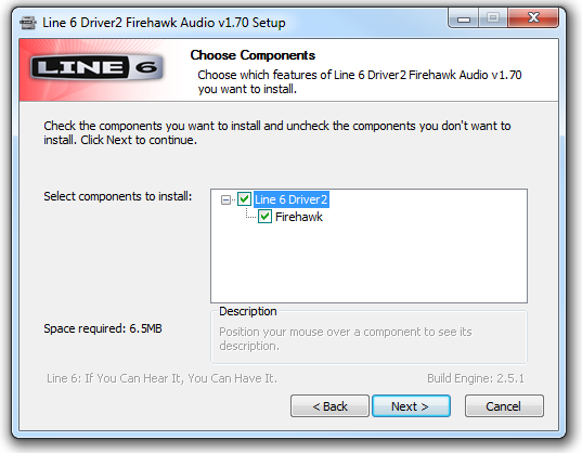

5.Disconnect your Firehawk from the computer if it's connected via USB and run the installer.
6. In the installer make sure the drivers from the Firehawk have a green check. Click next until the installer completes.

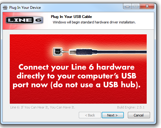

7. Reconnect Hardware when prompted and let Windows assign the driver. Now your computer will be able to communicate properly with the Firehawk. Make sure the Firehawk is turned on attempting when this.

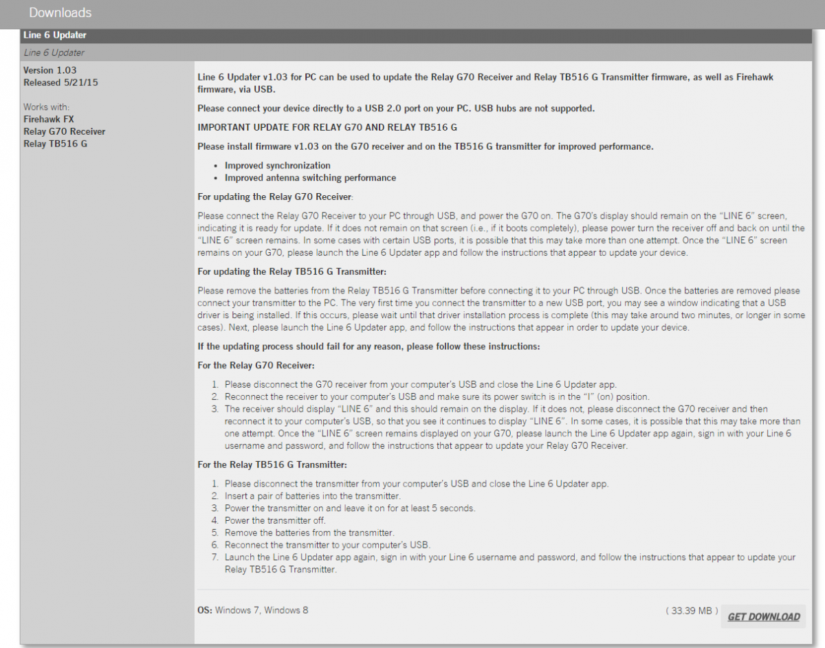

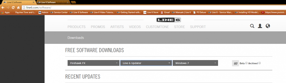

8. Now, lets download the updater utility. Open your web browser, navigate back to line6.com/software and select Line 6 Updater under the software drop down menu.
9. Select get download under the top selection:

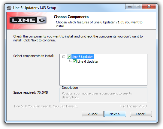

12. Run the installer for Line 6 updater.

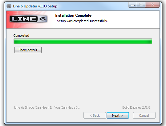

13. In the installer make sure Updater has a green check, click next until the installer completes.

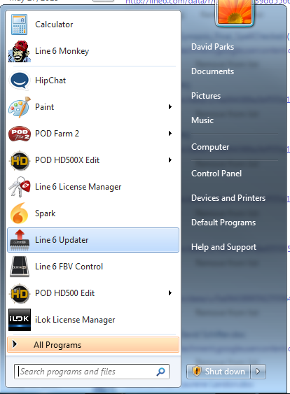

14. Run Line 6 updater from the start menu on WIn 7, Applications Folder on a Mac, or C:/Program Files (86)/Line 6 on Windows 8.

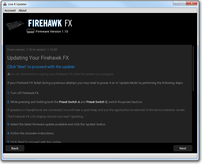

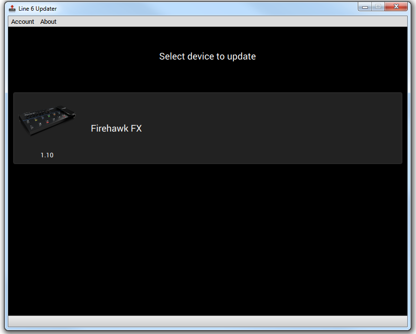

17. Select the Firehawk.

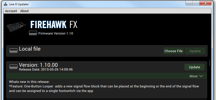

18. Select the latest version of flash memory. This is always the top selection.
19. NOTE: This part of the updater explains how to reset the Firehawk if it should fail. You can refer to the image here for instructions if that should ever happen. Click Next to Proceed.

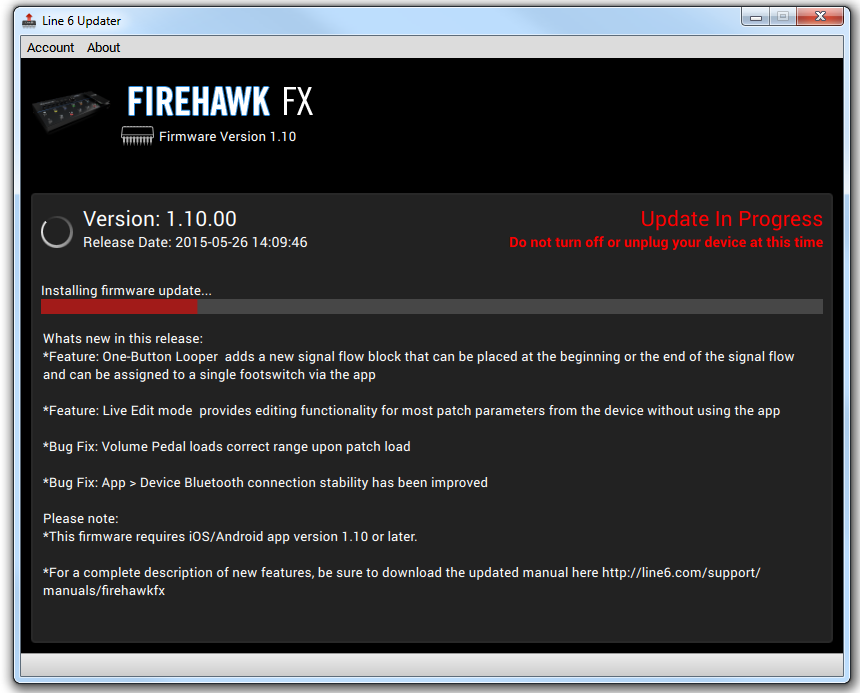

20. Wait for the progress bar to complete.

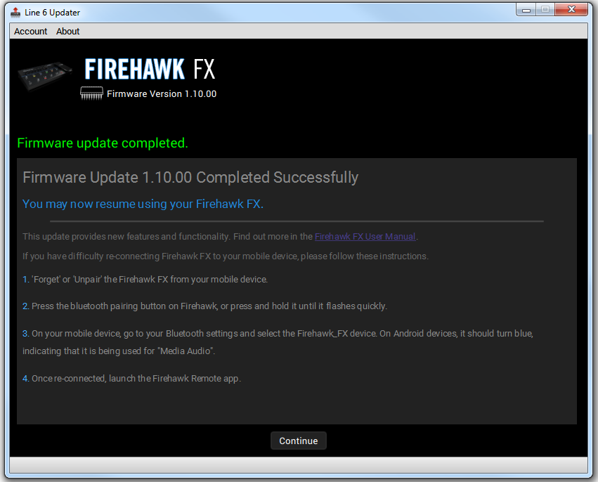

21. Updater will let you know when the update is complete.
