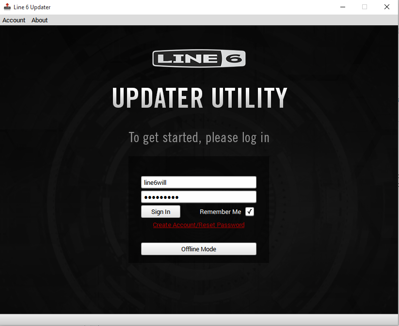

Step 3:
With your Line 6 user name and password, log into the program.
https://line6.com/media/ips/uploads/monthly_06_2016/ccs-1912763-0-27072600-1466703732_thumb.png

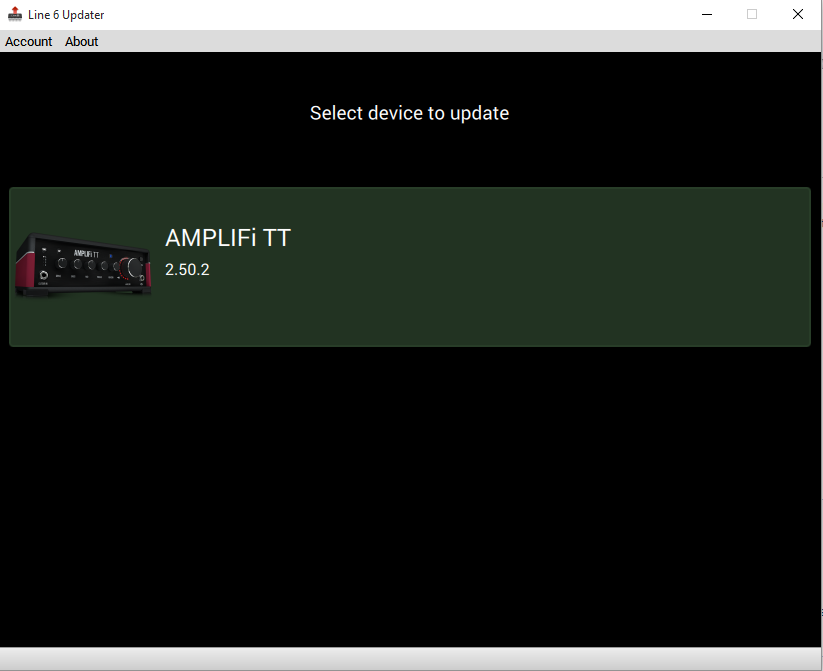

Step 4:
Click on the connected Amplifi. Here, we're updating the TT.
https://line6.com/media/ips/uploads/monthly_06_2016/ccs-1912763-0-07623000-1466703737_thumb.png

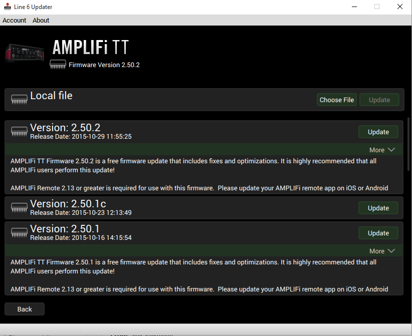

Step 5:
Click on the latest version of firmware from the top of the list. You do not have to install each previous version, just the latest.
https://line6.com/media/ips/uploads/monthly_06_2016/ccs-1912763-0-33793600-1466703741_thumb.png

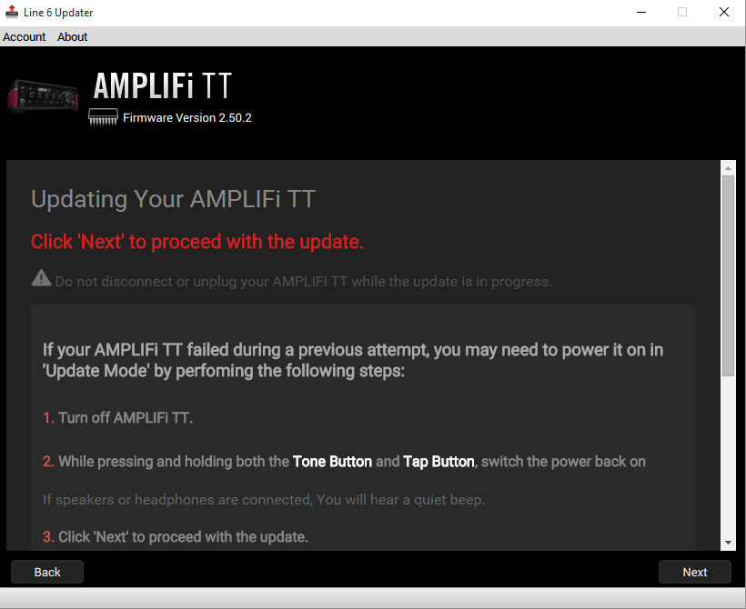

This page shows you what you'll need to do if the update fails (we'll go over this at the end in detail). In the meantime, hit Next.
https://line6.com/media/ips/uploads/monthly_06_2016/ccs-1912763-0-59242800-1466703745_thumb.png

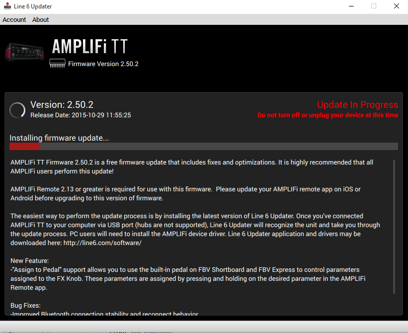

Step 7:
Here's the program doing its thing.
https://line6.com/media/ips/uploads/monthly_06_2016/ccs-1912763-0-64604400-1466703749_thumb.png

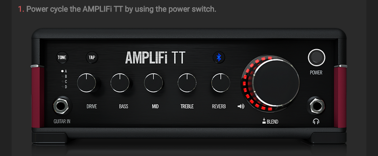

Step 8:
Once done, power cycle the unit.
https://line6.com/media/ips/uploads/monthly_06_2016/ccs-1912763-0-89119200-1466703753_thumb.png

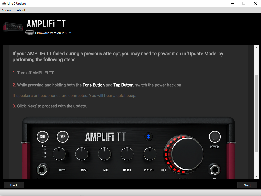

In the event that the update fails, or the gear isn't rebooting properly after the update, you'll need to enter update mode by holding down "Tone" and "Tap" while booting up. If using the FX100, hold down footswiches A and C.
