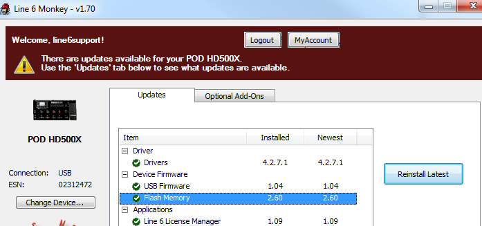

Before you Begin: Connect your POD via USB, open Line 6 Monkey and make sure the latest drivers are installed.
Next, the Flash Memory version on your POD must be version 2.60 or higher: And the firmware must be updated to version 1.04 or higher.

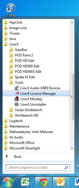

After your POD is updated it's time to run the License Manager. You can access it in the Start Menu on Windows or in C:\Program Files(x86)\Line6\Tools on a Mac it's in the Applications\Line 6 Folder in Finder.

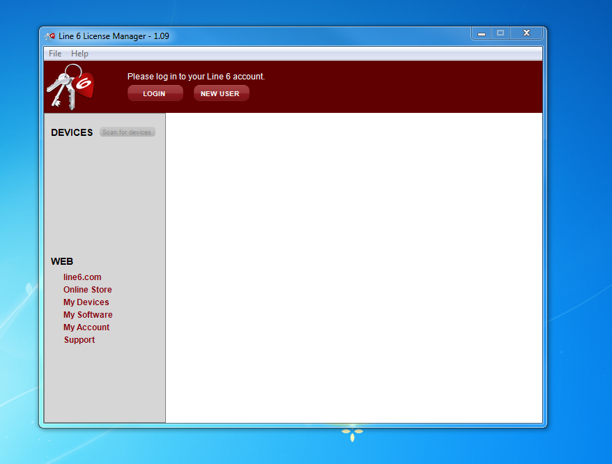

When License Manager opens it looks like this:

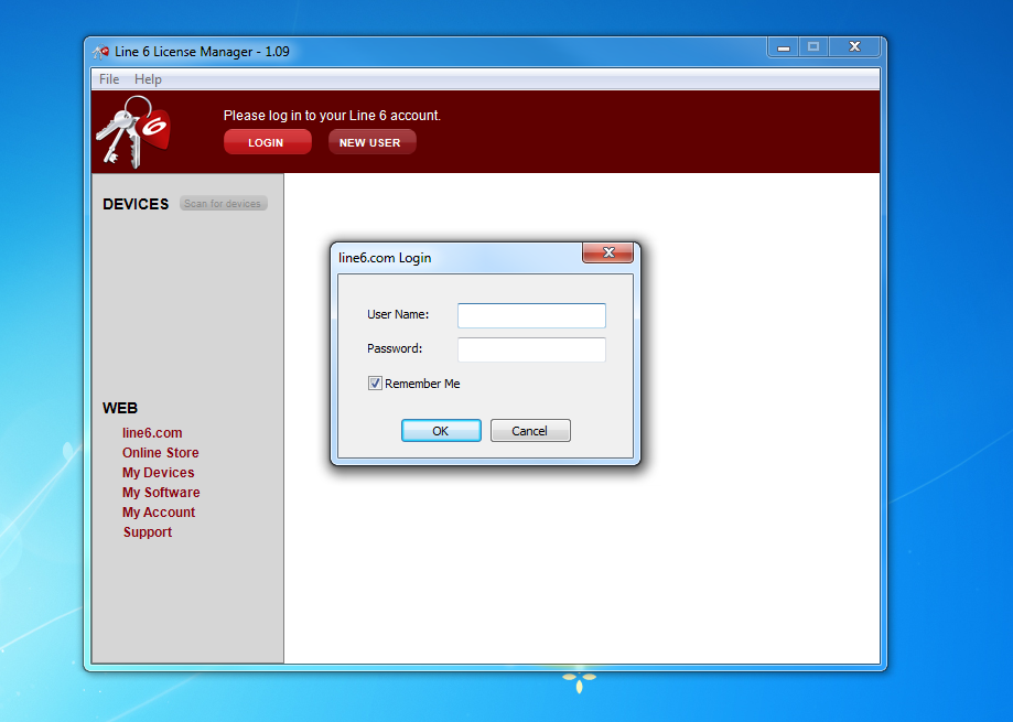

Click the Login Button and type your username and password for Line6.com:

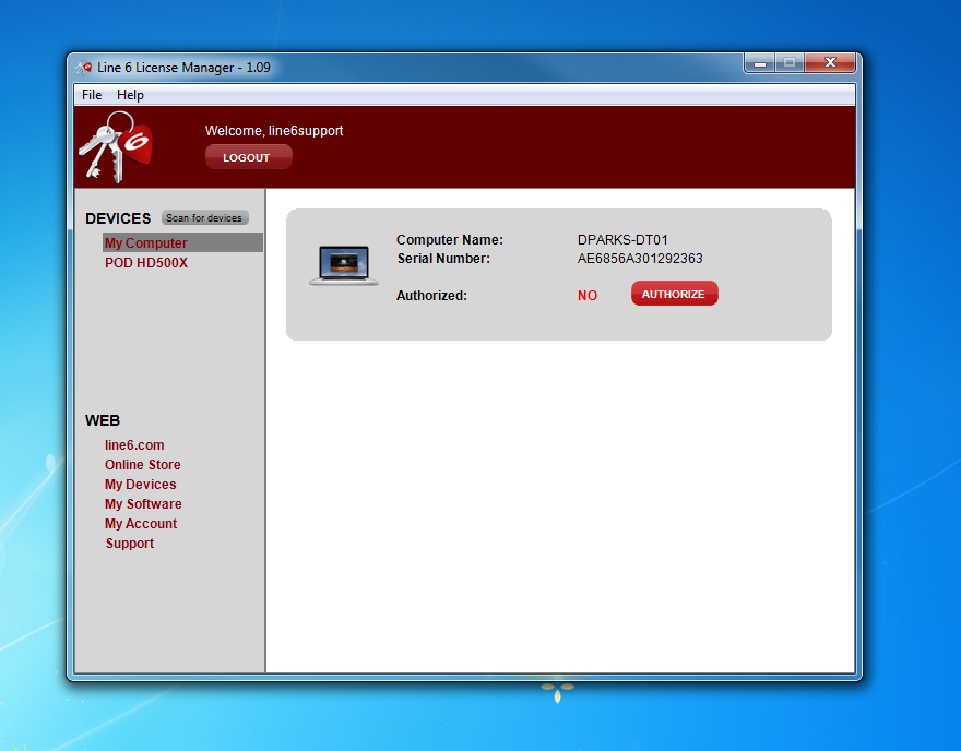

Once you are logged in, you will see your computer and the POD:

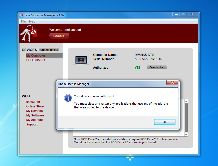

Authorize your computer first:

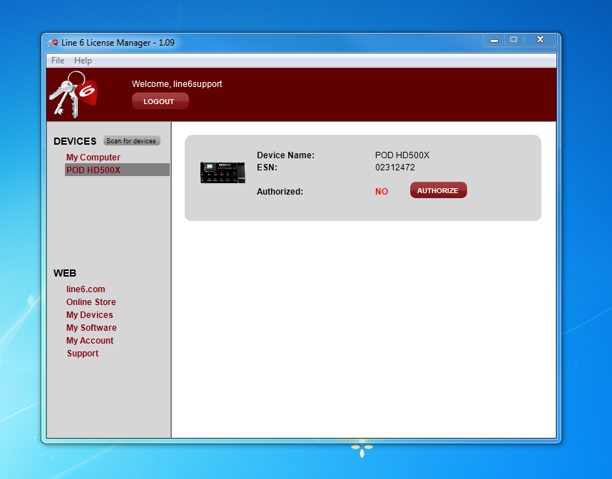

Then highlight the POD:

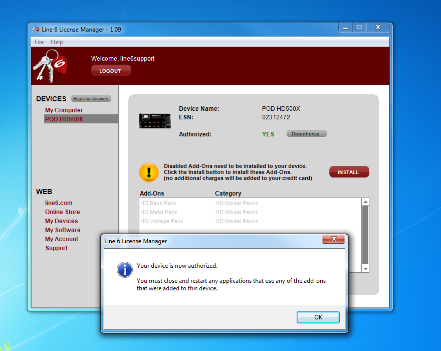

And authorize again:

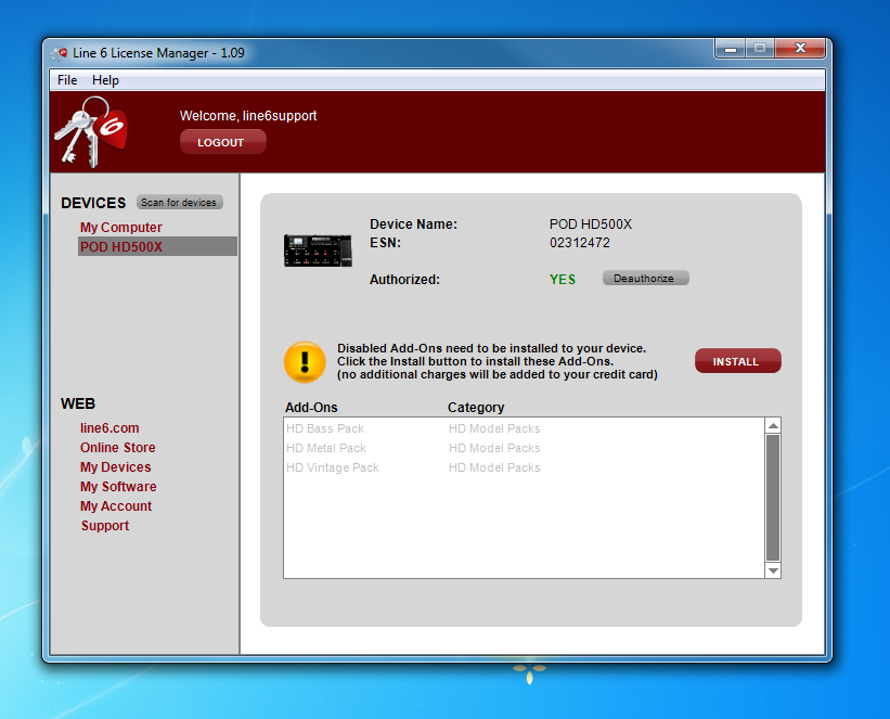

Next, the POD will indicate that there are add-ons that need to be installed:

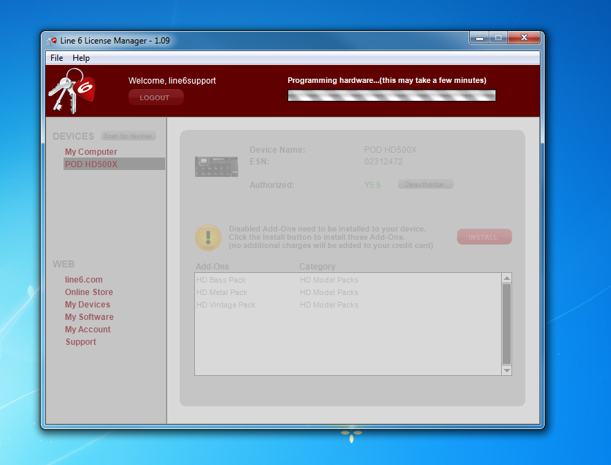

Click the install button to program your model packs on the POD:

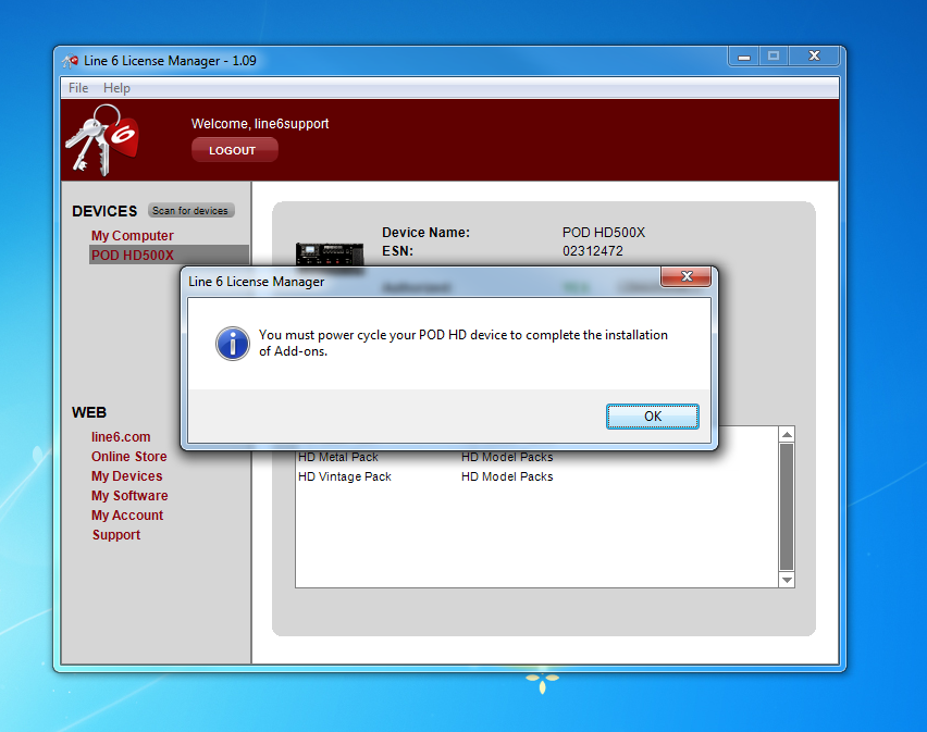

The POD will tell you to Power Cycle. Unplug the power for 5 seconds and plug it back in.

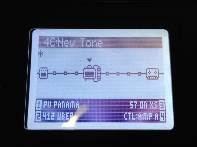

Now you can Check the hardware for your new amp models buy putting your cursor over the amp icon in a patch and using the first knob under the LCD screen to search:
